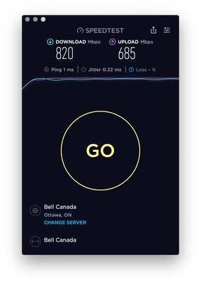

Hi fourms! I wanted to about others expereinces with wifi speeds on 5GHz Wifi frequency with the R8000. I have a brand-new R8000 running firmware V1.0.4.28_10.1.54 and gigabit fibre to the home...

So it looks like the firmware or router may have been the issue.
I returned the router and exchanged it for the same model. The firmware in the model I got is lower at version V1.0.4.12_10.1.46 rather than the later version I'd updated onto the other router I had.
I ran a few speed tests on this new R8000 - and the speed over wifi nearly matches that of the wired Ethernet now.
I'm happy! sometimes it is simply the hardware (or firmware... I can't say which - so I'll make sure not to update the firmware.)
