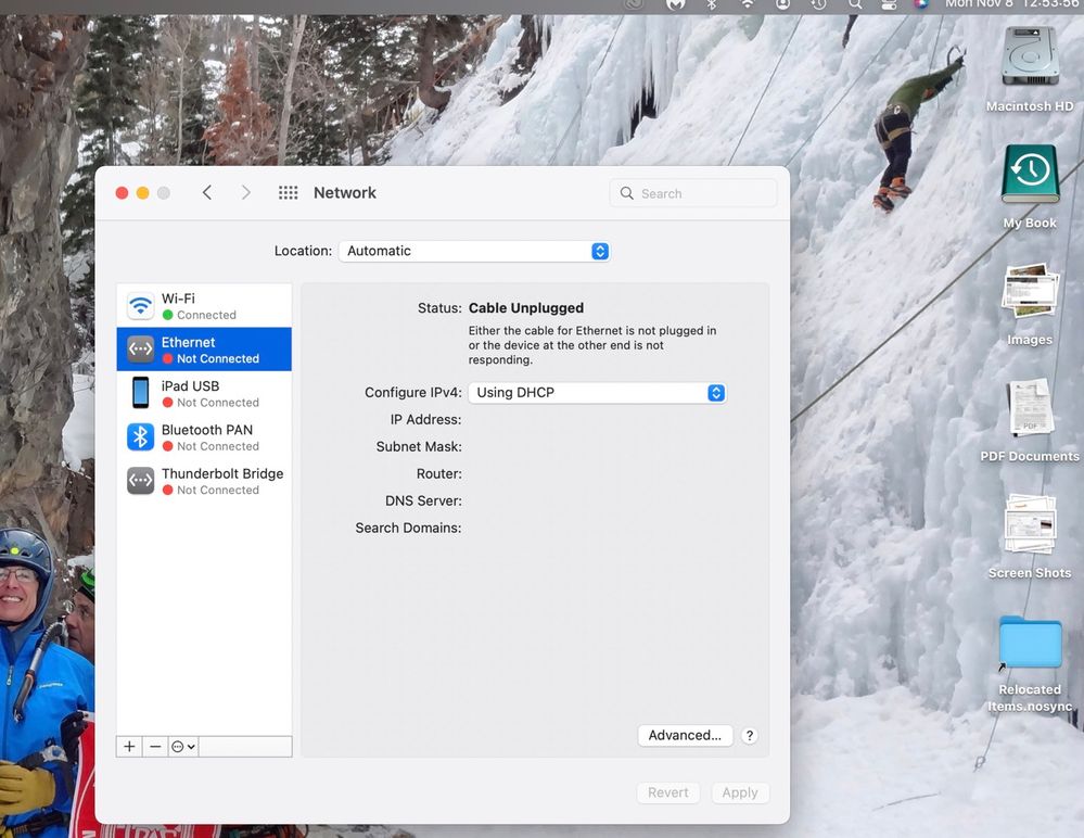

Unplugged everything. Waited a few minutes. Plugged homerun from computer directly into modem. Plugged everything back in. Waited and after a few minutes in the network choiceS, BOTH WIFI and ETHERNET go green as being connected. Yeah!
I disconnected the ethernet switch and only plugged in available ethernet ports on the R8000. Unplugged everything again, waited, plugged in modem, waited, plugged in modem waited plugged evrything back in.
But now on the home run from that computer, red "ethernet not connected"- cable unplugged and Wi-fi green "connected".
Don't know where to go from here.....
i thought when the home run ethernet went green and connected, which it has not done in some time, i thought i found the problem-the ethernet switch.
no idea now.
