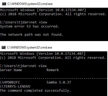

R8000-V1.0.4.28_10.1.54 update problems
Model: R8000, firmware V1.0.4.28_10.1.54 update, Win10 OS
I have a 2Tb SSD external HD connected to the USB3 port on the R8000 router using ReadyShare to allow access from my network. I had it setu...

I upgraded to the f/w level many months ago and have had no USB drive problems? Also on W10 V1809 Home with SMB 1 enabled.
Question, from a Windows 10 CMD prompt, what do you get when you issue a NET VIEW command? Does it work at all?
Wondering if you have a faulty upgrade, especially if it was done via wireless? Might want to re-try and see it if works.

- TJ_DartssNov 28, 2018Initiate
KiwiSpud,
Thanks mate. I checked the CMD Net View and it returned a "System Error 53". I got the same error from my other Linux laptop as well.
I downgraded my systyem back to the V1.0.4.12_10.1.46 build and vwala, no 53 errors and my ReadyShare is visible in my network again!
Before/After pics below.
