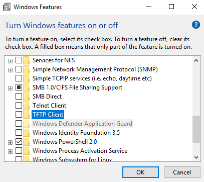

TFTP can be used to recover the router in most situations. You don't have to download the utility if you have windows 10, it's a windows feature that can be enabled. You will use it to reflash the FW. Very well documented. Timing is everything, so don't be discouraged if you don't get it the very first time you try.
https://kb.netgear.com/22688/How-to-upload-firmware-to-a-NETGEAR-router-using-TFTP

Wasn't 100% convinced this would work but it does !!!
On Win10 you just need to opern a command prompt and then its a tftp command
c:\ tftp -i 192.168.1.1 PUT c:\netgear.fw\<filename of fw>
worked a treat ..!
