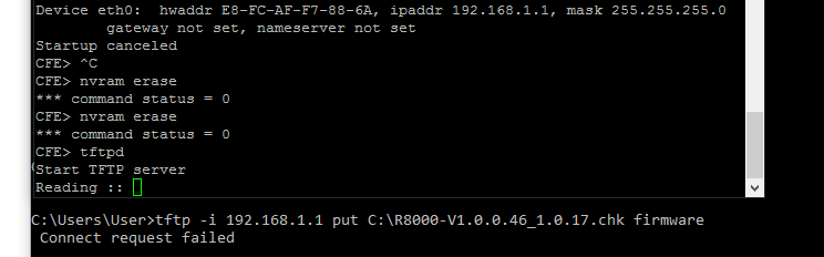

- demonstrativeJul 11, 2017Aspirant
Hi Peter11742
I was going through this thread "R8500 bricked" earlier because i am encountering a similar situation R8000. I followed your steps but encountered some differences. I was wondering if you could lend me some advice.
Just some background, i bought a bricked router R8000 from someone who claimed it is fully working. After i realised it was bricked, i decided to get serial cable, disassembled the chassis to fix it. Please bear with me as this is the first time i am doing this to a router, i usually use routers off the shelf.
Back to the steps you have listed. using it as a checklist so you can see the steps i completed.
1) J4 connector pins : 1 2 3 4 pins are visable by looking the motherboard and they are located in the front view.
and j4 mark is located next to #1 pin. 1 gets green color, 2 gets white color, 3 gets green color, 4 is not connected. Done
2) open the bottom cover by removing the 6 tork screws.
Take the cover half way out so you can see the j4 plug and plug the serial cable.Turn on the router. Different router, i remove everything until i get the pcb board, plugged in my USB-TTL cable (similar to serial cable) Done.
3) Start Putty let it run for a minite or so and start sending control c commands until you will see CFE. If i wait for a minute to start sending control C command, I cannoit get into CFE. so i started once putty starts. I got into CFE.
4) on CFE type nvram erase you will see a 0 as an answer. Done
5) On CFE type tftpd you will get tftpd server ready ::Done
At any time now press control c untill you see CFE run nvram erase get a 0. Done
On CFE enter tftpd and waight there. Done, but see screenshot below. PuTTy just stops there, router lights also stops blinking. believe it is turned off. Is it supposed to be like this? Do i continue with the next step of going to doc cmd?
Any help will be appreciated. Thank you in advance!
Demonstrative
- TheEtherJul 11, 2017Guru
The tftpd command tells the router to wait for a TFTP transfer. You need to initiate the transfer from an Ethernet connected PC or Mac.

- demonstrativeJul 12, 2017Aspirant
Sorry my bad. i forgot to mention that the Ethernet cable has been connected from the beginning.
After starting TFTP , I typed in cmd>tftp -i192.168.1.1. put C:\R8000-V1.0.44_1.0.96.chk firmware
I waited for the pop up you mentioned, but there was just nothing happening.
Can i check if the line i type is correct?
my R8000....chk file is placed in C:

- demonstrativeJul 27, 2017Aspirant
Hi peter11742
please see screenshot. Connect request failed.

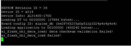

any idea why this happens? am i misssing any steps? - TonyGeJul 29, 2017Aspirant
Hi All.
I am stuck on CFE after following all the steps in this thread, I have Putty connected, but getting the following error:
data cheksum validation failed. Any idea if possible to get CFE prompt?
- peter11742Jul 29, 2017Luminary
The only solution that I can tell you is the following.
Take the power from all you devises off that means the router and your computer.
Now work on your router alone Make a procedure that resets the router by pressing the reset button and waiting 30 seconds.
Now you can start again with the putty and dos procedure. It should work because I had this problem and now the router works with the first firmware from NetGear. Good luck.
Peter11742
Thank you, Peter.
I have already tried that before. Reset is totally dead and not doing anything. I did power off/on, 30/30/30 reset, nothing seems to work on this router. Putty always brings same message when checking EEPROM.

Puty shoud work if the plug is inserted properly.
Configure your TCP/IPV4 to 192.168.1.10 on your computer with the connection properties.
Start with 30/30/30 and continue with puty and let it run for 2 minutes then cntr c and get cfe.
CFE you must eraze it nvram erase and get 0 type tftpd and follow the putty screen will say tftpd server ready.
Then go with the dos comand CMD>tftp - 192.168.1.1 put your oldest netgear file.chk
You will get if all is correct from dos and putty file transferred sucesfull.
This should work I did 6 units and they all work with the old sofware with out any problems.
Use a laptop so you do not have to worry about your settings later.
Good luck post your problem again if you have still problems.
