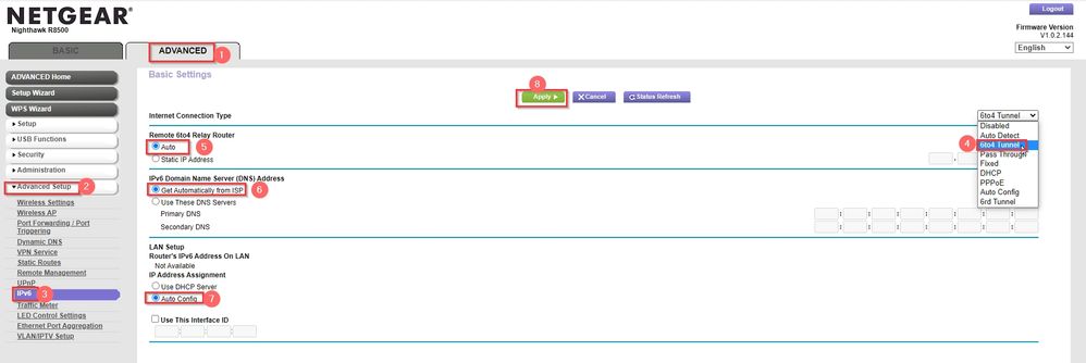

Hi All,
When I enabled the IPv6 Setting to 6to4 Tunnel, The Speed is Incresed very fast and I'm not getting any DNS issue as well. I'm Still rolled backed to V1.0.2.144 and didn't tried the V1.0.2.150. I hope this will help to everyone
- FURRYe38Apr 18, 2022Guru - Experienced User
Subject: "Known DNS problems with solutions"
Summary: Several people reported DNS issued related to PROBE or non-response from websites
NG pending actions: NG engineer team is aware of the problem, they are working on it. It does take some time for development and testing. In meantime, users can try enabled IPv6 to see if this corrects the DNS problem or revert back FW to what was working.
Please be patient.
