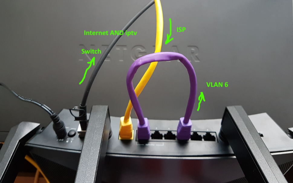

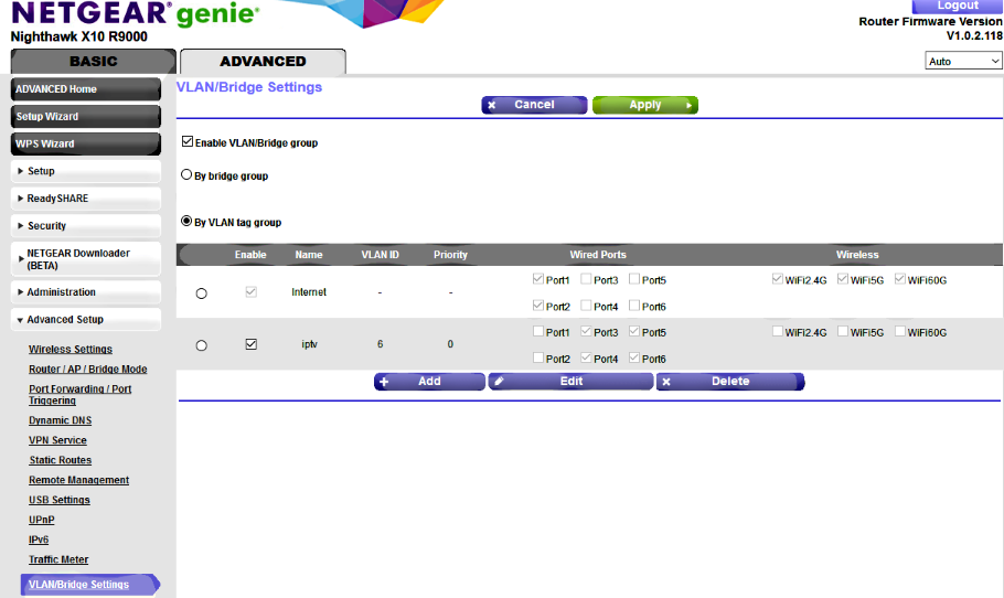

You may believe or not, but I'm now testing the following setup (look at attached pictures) :smileysurprised: In three days I had only one complete disaster (solved by restarting of R9000)...
