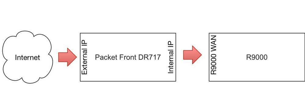

When you said an IP address of 10.0.0.1 was assigned to the R9000, I wasn't sure if you meant 100.64.x.x etc, hence the question and wanted to check - but it sounds as though we have got to the bottom of that part of the problem.
The problem you will face is the double NAT that you currently have with the current set-up.
The R9000 will not do UPnP unless it is in modem mode, and has a real-world IP address assigned to the WAN interface.
If the R9000 is opening up the port to the PLEX using UPnP, it will be stopped from getting to the WAN port from anywhere by the NAT of the Packet Front DR717.
I have no experience of your ISP or the Packet Front DR717 - if there is a link to a userguide that could prove helpful.
It's possible that setting up a port-forward rule from any to the R9000 on the Packet Front DR717 might work, but it's kind of a long-shot.
What you have is the following...
What this means is that the DR717 is NATing the External IP address to an internal range, which the R9000 is picking up as the WAN port.
How did this use to work? Did the R9000 WAN port get an external IP address?
It might be worth going back to your ISP and asking if the DR717 can be put into bridge mode, so that it's only working as a modem and the R9000 is doing all the authentication, and therefore will get the external IP address you need.
