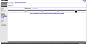

R9000 Port Forward Issue w/ Game Servers
In short, I have tried for many months on and off to get port forwarding working for game servers like Minecraft, Garrys Mod, and Unturned but it has never seemed to work. Things ive done: - I h...
