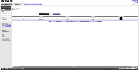

R9000 Port Forward Issue w/ Game Servers
In short, I have tried for many months on and off to get port forwarding working for game servers like Minecraft, Garrys Mod, and Unturned but it has never seemed to work. Things ive done: - I h...

Thank you for responding! My modem is a Ubiquiti UF-LOCO
plemans
Nov 18, 2021Guru - Experienced User
the model has a bridge and a router mode. what mode are you in?
- VicyXNov 18, 2021Tutor
Im not sure. Im trying to access the modem but the default UFiber username and password dont work. I did not change it but my isp might have

- VicyXNov 19, 2021TutorYeah i tried to do ubnt as the username and password but it didnt work. My isp must have changed it when they were setting it up
If the modem was in router mode, then would the netgear router even work? Also there is no other netwroks that show up on the wifi other than the Netgear router's wifi
- FURRYe38Nov 18, 2021Guru - Experienced User
Does this ISP router have a DMZ? IF it does you can use it's DMZ for the R9000 if the ISP router can be bridged or disabled.
I do not know. I have emailed my isp for the login credentials of the modem so I am waiting for a response before im able to view the settings of the modem
