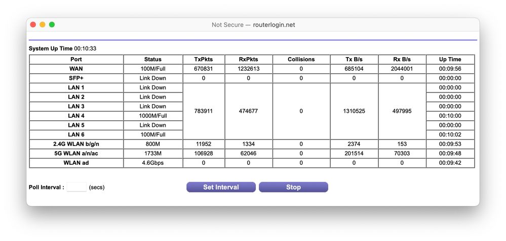

- plemansSep 03, 2021Guru - Experienced User
what do your connections statistics show for port speeds?
How do I display Internet port statistics on my Nighthawk router? | Answer | NETGEAR Support
- antoinekinchSep 03, 2021Guide
Can you see this?
