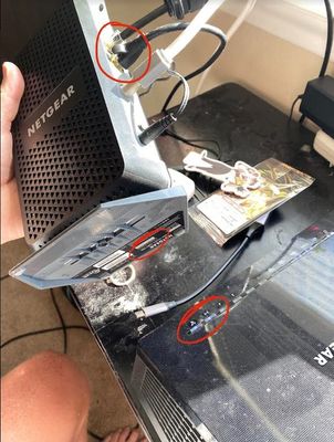

See below. I was unable to connect my work laptop to the second ethernet cord, they have it locked tighter than Fort Knox, so I'm busting out my old personal desktop to see if I can connect it successfully

If you can't see anything, what do the WiFi LEDs and the WiFi On/Off button on the R6700 look like?
See below:
- michaelkenwardJun 27, 2023Guru - Experienced User
The picture tells me nothing.
It is simply not possible to have two devices with a LAN connection to a modem. It doesn't support that function.
As to the WiFi LEDs, they are not visible.
