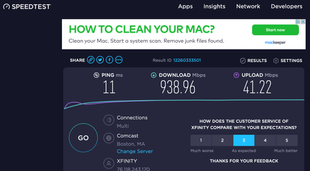

Rocket internet speed, wifi sucks
So all of a sudden, my wifi speed is down to slower than a crawl 20-30 mps. My wired speed on my Mac is thru the roof as it always has been, but I'm trying to stream (anything) on my smart ...
