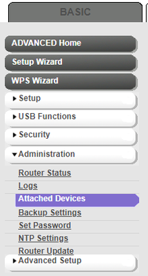

Router Nighthawk X6 R8000, firmware V1.0.4.84 -web interface freezes
Hi all, I have confirmed that in V1.0.4.84, when editing any attached device (under Administration) to change its priority, after clicking on Apply, the web interface freezes up and the router must ...

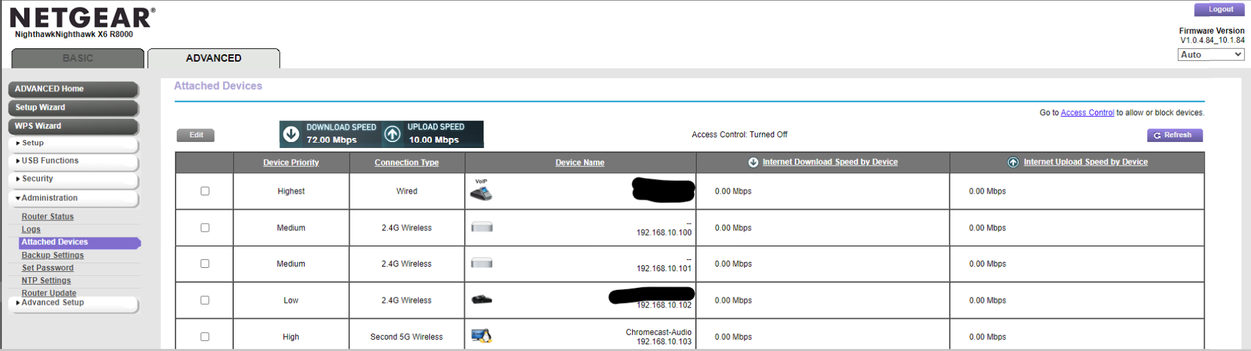

Ok so after enabling QoS,
I now see the Edit and same screen view on Attached Devices:
Selected Low priority and hit apply and got same hang on the browser:
Seems to crash the web page ui services. I still have internet access thru the router. I can ping the routers LAN IP address as well. Power cycling the router regains access to the routers web page.

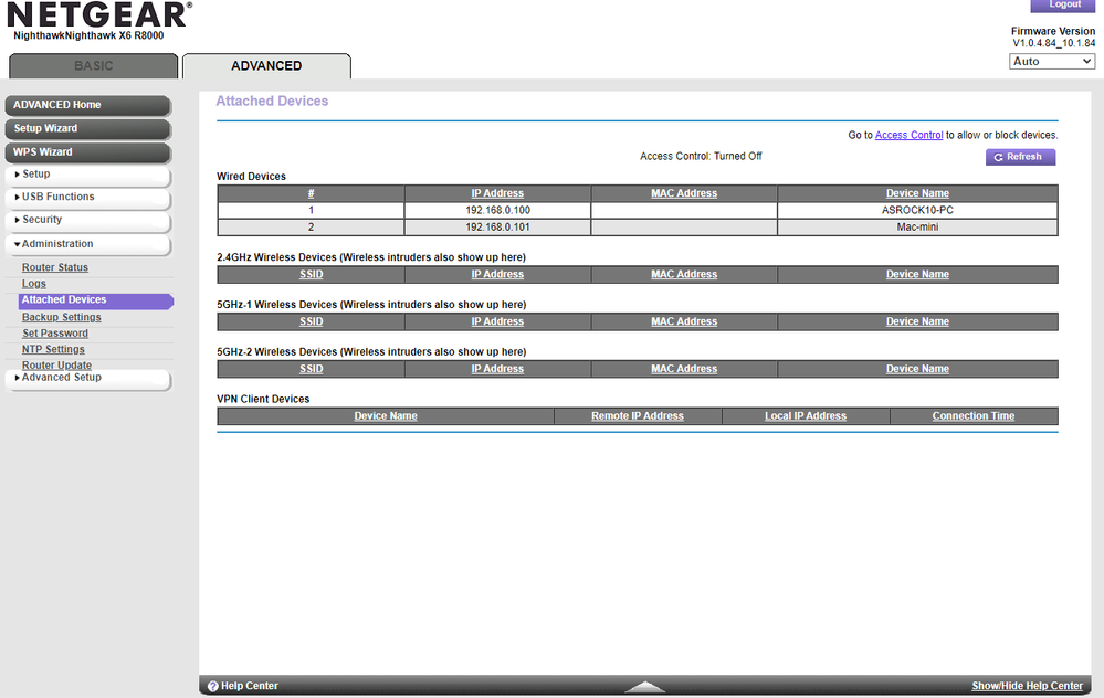

We have the same router with same firmware version but yet different interface... not sure I understand the reason behind it...
You won't be able to test it out then... I'll download FireFox anyways and try but I doubt that will be it because in v82 I used exactly the same PC and browser to change the priority and worked no issues.
Thanks again.
- FURRYe38Oct 18, 2022Guru - Experienced User
Ya I don't see that layout on mine at all. Speed test shouldn't be appearing on that screen either. I use MS Edge.

Do you have Dynamic QoS enabled?
- ITMinionOct 18, 2022Star
Oh... very good point... yeah I do... that would make sense...
