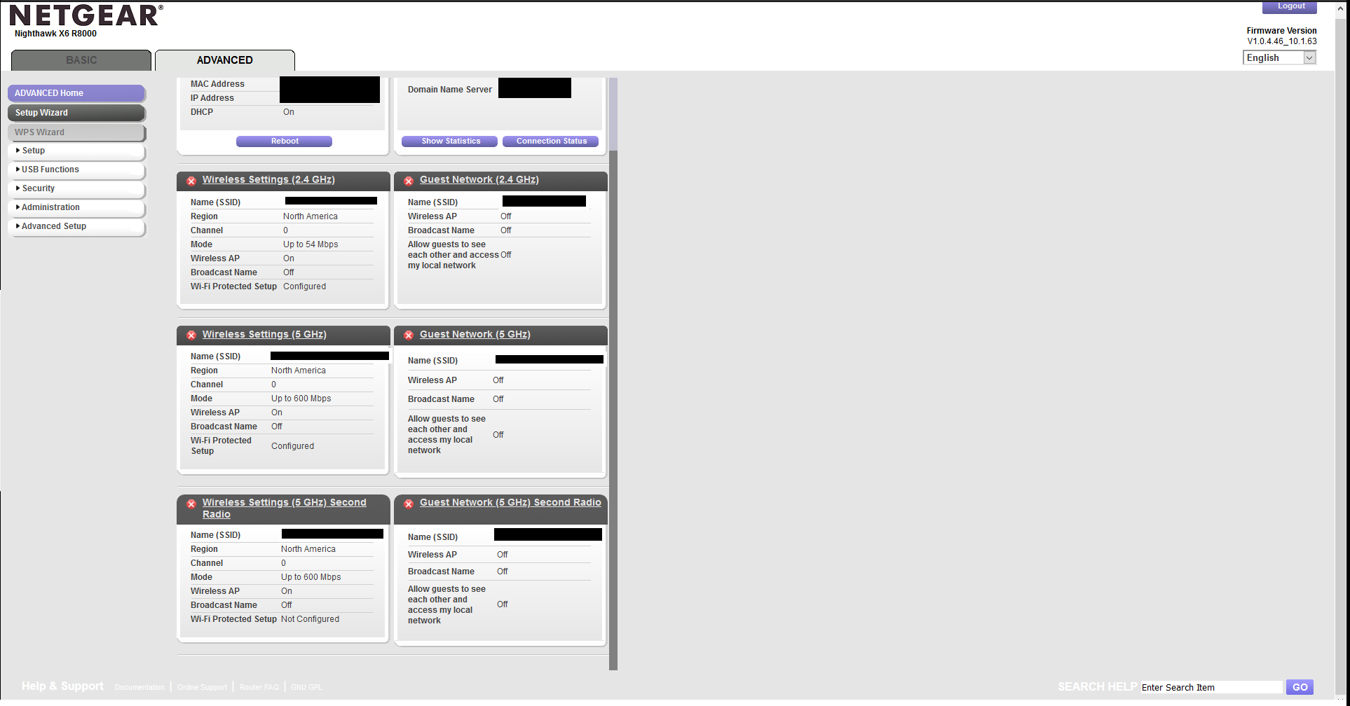

The router no longer responds to resets, even if the reset button is pushed and held on for at least 30 seconds. I have to wait almost 2 hours for the router to reboot, and unfortunately, not every component comes on. It seems as if the Wireless component of the router is dead. LOL. See attached screenshot for more details. I have disabled WPS (the very first thing I did when I got the router) and now it claims it is configured. Using the Wi-Fi on/off button has no effect on turning on or off of the Wireless function of the router.
The next step:
I will downgrade one version to R8000-V1.0.4.28_10.1.54 and see if it will bring the Wireless feature back on.
If it fails, I am likely to get a replacement router of the same model. I have already found a seller and I am just waiting for the result of the downgrade to see if I need to proceed or not.
