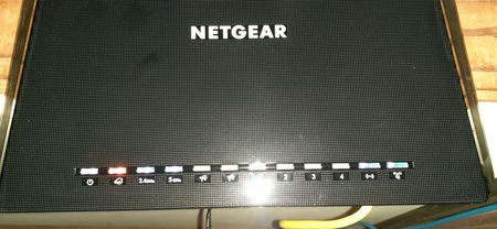

Router won't connect to modem internet
Hello, I'm writing today to see if anyone can help me with my problem. I recently have encounted a problem on my router after a mini power outage. I have done all the usual steps to get it to wor...
Jumpy121
Apr 12, 2021Aspirant
Hey thanks for the fast reply.
1. I have a Ubee Modem from Spectrum
2. My router is r6400 Nighthawk
3. my firmware is: Firmware Version V1.0.4.106_10.0.80
4. My modem works connecting to it via ethernet so I know it's not the modem. The issue is that internet isn't being received from the modem for some reason and I have no idea why this happened after a mini power outage.
5. I have full access to my router
