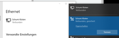

This first image shows my 4 wireless SSID's and no wired connection (CAT-5 cable unplugged):
- MiWiFi2 is the 2.4Ghz private network (internal)
- MeWiFi is the 5Ghz guest network (external)
- MiWiFi is the 5Ghz private network (internal)
- MeWiFi2 is the 2.4Ghz guest network (external)
The second image shows that I turned off WiFi and plugged in the CAT-5 cable. The wired connection now points to the internal private 2.4Ghz network and the wireless connections are no longer shown.
The third image shows the Network and Sharing Center and identifies the wired connection as MiWiFi2, a private network with an Access Type of Internet and a Connection Type as Ethernet.
As stated in my original post, sometimes the private network associated with the wired connection shows the SSID, MiWiFi, which is the 5Ghz network.
I guess the bottom-line question is does it matter which SSID is displayed for the wired connection. If not, this is, at best, a misleading "feature."

The puzzle is how you think the wifi SSID has anything to do with your wired connection.
It looks to me that you are confusing the name of your local wired Ethernet network with the SSID. Just because they have the same label does not make them same network. It may just the tag that Windows gave your router. This is something that Windows does all the time.
For peace of mind, try changing the name of the Ethernet network. Or change the wifi SSID and reel back in shock as the Ethernet network keeps its original label.
- schumakuNov 22, 2020Guru - Experienced User
WMM2 Your simple consumer router does only have -one- network.
One network, the normal wireless SSIDs do connect transparently to the very same network, also accessible b the Ethernet LAN ports. Because of the router does enforce two different SSIDs or network names, Windows 10 does identify these as -two- different networks.
And then again the very same network, also used by the guest SSIDs connecting (to what extent see above), allowing your guests to access the Internet using the network at least as an intermediate network to access the Internet. Windows 10 does identify these as -two- different networks again.
When looking on the Windows 10 system, each of these four connections will be identified as an individual network. On connecting for the first time, each network is designated as a "public" network (and various firewall rules will be set accordingly) - unless the user does (during the first connection, or manually later) each to become a private network.
This isn't a feature - it's just the way it is, and how wireless routers are made for a decade or more.michaelkenwardand antinode I'm happy to put up links to the fine documentation. However, I'm with WMM2 as a user, and here is why:

connection and a router wireless SSID.It's the very same network - the same default gateway, the same router MAC, .... - so Windows (ey even MacOS!) does take it as the same network. regardless if the computer is connecting using the built-in 2.4 GHz adapter, the 5 GHz adapter, the 60 GHz adapter - all using wireless links, or the built-in 2.5G Ethernet, the USB3 connected 5G Ethernet, or the TB3 connected 10G Ethernet adapter - all using wired connections - brilliant, isnt it?
antinode wrote:Which are two different things.
Still the very same network, the same LAN, the same VLAN, ... Different adapter, different media. different speed - granted.
I know it's often mistaken that the SSID does reflect the label atached to the cable outlet or the switch port.

- The Windows (wireless) network name is based on the SSID - for a reason it can't be renamed, isn't it?
- Windows does allow to "Show available networks" and does list the SSIDs available on-air. It does not say "Show the available wireless network access point radio.
- Windows 10 does identify and name the wired network connection according to the wireless SSID connecting to the same network.
Bottom line revision now?
