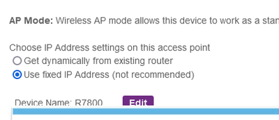

    The easiest way to get that is to put the R7800 into AP mode, as Kitsap suggested.
    The RAX48 is more recent, and probably more powerful, so maybe best used as the main router. For example, I find that my R7800 does not support some of the features I can use on my MR router, such as IPv6 for my ISP.
    For your second request, you can fix the IP address of the R7800 in AP mode, and then just aim a browser at that to log in. You can even set it up so that both router and AP will show in the Nighthawk mobile app allowing you to get at them with Anywhere Access.
    You can fix the AP's IP address when you turn on AP mode.
    Or you can leave it to your main router and give the R7800 an Address Reservation there.
