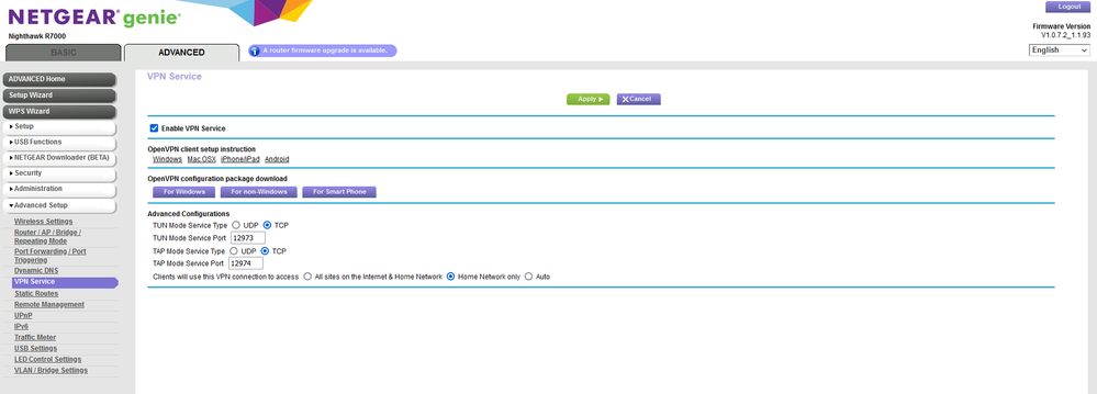

Setting up login credentials for OPEN VPN
 Hello,  I have a Nighthawk R7000 rooter with a default OS (which I can't change).  I have for several years activated the vpn service with open vpn which works very well.  However, I'd like to increa...

Feb 29, 2024Master
ADOZ2AD wrote:Hello,
However, I'd like to increase security to connect to my rooter (and therefore to the connected nas server): set up a login and password connection.
Is there a (simple) solution for this type of connection via open vpn?
Is it possible to give rights to certain identifiers or remove them?
I'd like to stop distributing the identification key, but to grant connection rights.Thank you in advance for your reply.

- ADOZ2ADMar 01, 2024AspirantI've come to ask for help here because I use the basic netgear os and the basic openvpn vpn option. - michaelkenwardMar 01, 2024Guru - Experienced UserYou referred to "the connected nas server". Most NAS network attached storage (NAS) devices have their own OS. If you mean the DLNA sever on the router, that's something else. Not really NAS. - ADOZ2ADMar 01, 2024AspirantNo, I'm talking about the Nas, which has its own system and I connect to it via its IP (physically linked to the rooter).
 To access the Nas, I go through the rooter and connect to it with OpenVpn.
 OpenVpn is configured using the rooter's original settings, so it's an open vpn key connection.
 I'd like to change this connection to an ID and password system, is that possible?
