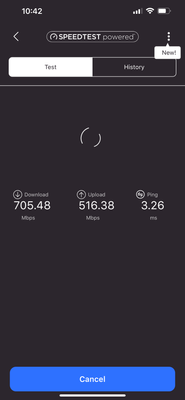

Slow WiFi speed from AC4000 X6S
Hi; I have the R8000P (AC4000) and about two weeks ago noticed my WiFI speed dropped precipitously from between 300-400Mbps to about 150Mbps. I am on a fiber gigabit plan through my ISP provider. I...

Thanks, and yes, I understand that. If you notice in my post I tried to point out that prior to the last few weeks I consistently DID get between 3--400Mbps which is what I signed up for an expect. But all of a sudden, beginning about 2 weeks ago it dropped down to 150Mbps? Why?

Thanks for letting me know and much appreciated. But if Beta only it’ll not be available within the app. But if this proves to be safe (insofar as enabling IP reservations, do you understand that there will be no changes to my reserved addresses? If so I can easily wait for the official release and will perform update at that time. For the time being I’m ok with the shower speeds. That said, I still don’t understand why my Netgear app shows speed of over 700Mbps!
