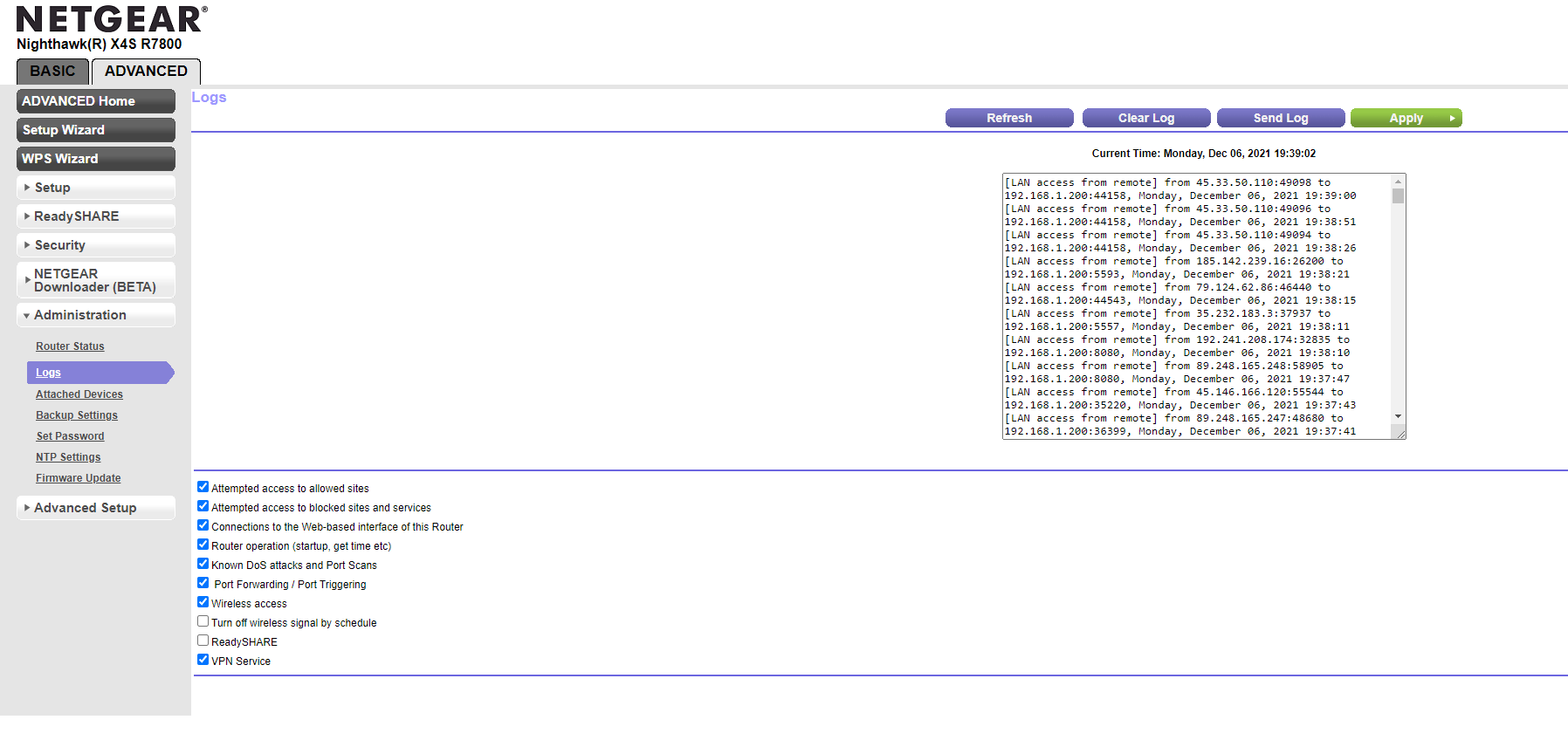

Trying to open port 44158 on X4S R7800
I have spent countless hours trying to open port 44158 for my Helium miner on my R7800 router and I believe that I have done everything correctly and the port still shows up as closed. I have set...

Yeah, I tried it previously knowing the security risks and took it off quickly right after it didn't work. I just tried again and it did not work, so I took it off the dmz again.
The ping that I am sending to the miner from the port checker is being documented by the router's logs (image attached) even though it is showing up as closed.
