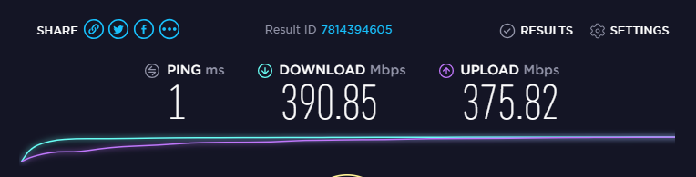

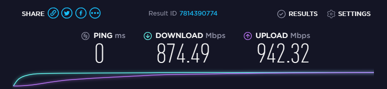

- acecryzNov 20, 2018Aspirant
Connected to my R7000Connected to my tp-link TL-SG105
Here are the speeds I'm getting.
