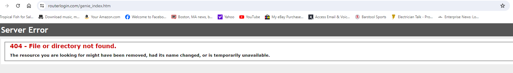

Your products are broken after factor resets i can not access the firmware to configure them i just keep keep getting a 404 error file missing this is with both my c7000 and R9000 modem and router.
If you are running these together, then that is a recipe for chaos.
The c7000 is not a modem. It is a modem.router. The R9000 is also a router.
After a reset, both will be in router mode. Neither is broken. They are just doing what you told them to do.
Two routers on your network can cause headaches. For example, you can end up with local problems with addresses on your network. Among other things, the other router can misdirect traffic to addresses that the Netgear router usually handles, such as routerlogin.net or the usual default IP address for a router, 192.168.1.1.

issues resolved they are back working factory reset seemed to corrupt the firmware and i couldn't access the configuration software i was getting a 404 error on both devices. i ended up doing a 2nd factory reset and the error went away and i was able to configure both devices again. just frustrating when things don't work as they should. i guess i should have done the 2nd factory reset before complaining.
