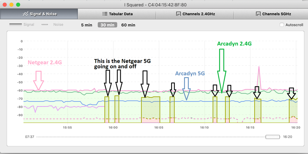

Certainly the NetSpot application has been helpful in visualising that, for me at least, part of the problem has been the signal starting and stopping.
One tip that was suggested was reducing the power from 100% to a lower level. Watching the Signal and Noise graph on NetSpot I noticed (sorry no pics - its dropped off the end of the track now) that
- the R7000 swapped from randomly turning the 2.4G on and off to providing that consistently and to turning the 5G on and off instead
- when working, there was no appreciable difference in measured signal weather at 75% or 100%
I also have tried one other change, which has for the last 6 hours at least given stable signals in 2.4 and 5G according to the graph and that was to turn off SmartConnect. Whether this has actually done anything is another matter, but whereas most of the day has had one or other signal going on and off I've had a steady signal since then.
