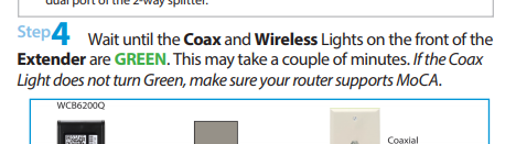

I used these instructions:
https://www.actiontec.com/wp-content/uploads/2017/02/WCB6200Q_QSG.pdf
I already contacted the actiontec and they stated the device is working properly since I connected it to the modem and to my laptop and there was internet. The coax light is not working and they said to contact netgear about that. Is this because my modem is using the coax line and I cannot use multiple coax lines in the same house? If so, would a coax splitter work?

Its because the C7100V doesn't have MoCa. The instructions specifically state it should support MoCa.
I screen snipped that part.
