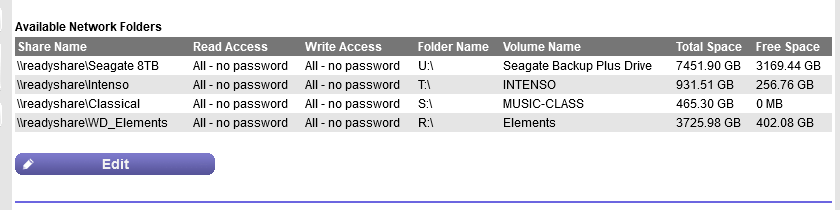

What does it look like when you aim the browser graphical user interface (GUI) at the ReadySHARE settings?
I see this:
