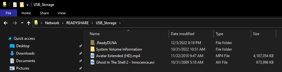

win 10 pro asking for readyshare password r9000
hi all I have the R9000 setup with 2 USB HD. I have only setup admin password and have no password set on the readyshare drives. i have no problem accessing the HDs from 4 TVs, a handful of tabl...
Dec 04, 2022Guru - Experienced User
Does your PC have a PW for it's log in?
I just got a R9000 in that someone sent me and I loaded it up yesterday with current version of FW.
I had a 500Gb SATA laptop drive sitting around and formatted it for FAT32 and connected it to a SATA to USB 3.0 adapter. Powered off the router, connected the drive. Powered ON the router. Checked the Routers web page under RS and it appeared there. No PW. I used the network path seen on this page and copied it into a Windows Explorer window and it immediately connected with out asking for a log in or PW. My PC doesn't have log in PW set. (All adults in this home.) I also have SMB 1.0 enabled for use with my older NAS devices I have. Windows 10x64 Pro PC.

- pspecDec 21, 2022Guide
It's all very strange.
I did try making a second account with the same name as router and no PW before the fresh install. but It didn't work.
I've now done a full install of windows pro but this time i used the same account name as the router and set no password.
and I'm in.
It's still asking for user name and password but it's now excepting the routers main user and PW were it didn't be for. Still don't have a password set on readyshare so doesn't make sense. .
still annoying having to enter user name and PW each time i reboot PC but hey I'm in.
