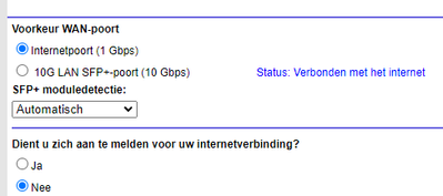

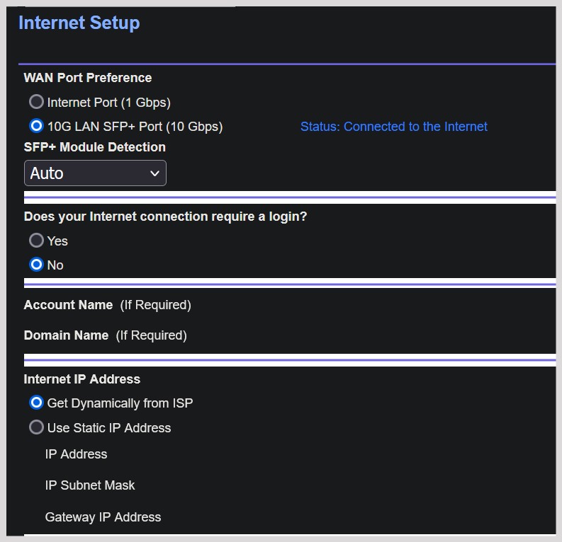

On my R9000, the SPF+ port can be configured for WAN function only. I use a SPF+/RJ45 adapter with an Ethernet cable connected to the 2.5 Gbps port on my modem. See attached.
What is the brand name and model number of the device you have connected between the R9000 and your internet connection?

Hello,
i installed it as on photo.
it is working great.
before my orbi was ir the RAX120.

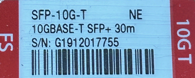

this is the module.
if it is not the good one pleae tell?
- tamme_tekkelMar 12, 2024Aspirant
hello,
module spf:
i have this. i am afraid to give the Ip adres of the systems to. Sorry:
see picture atteched
i hope this is what you ask.?
