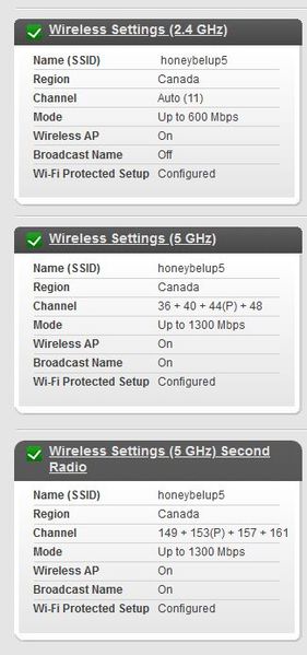

X6 R8000 and X6 EX8000 - devices are not switching to the best wifi
Hello, I have a router X6 R8000 connected through ethernet at the third third floor, and a EX8000 connected through ethernet at the first floor. On the R8000, I have enabled the smart connect. ...
