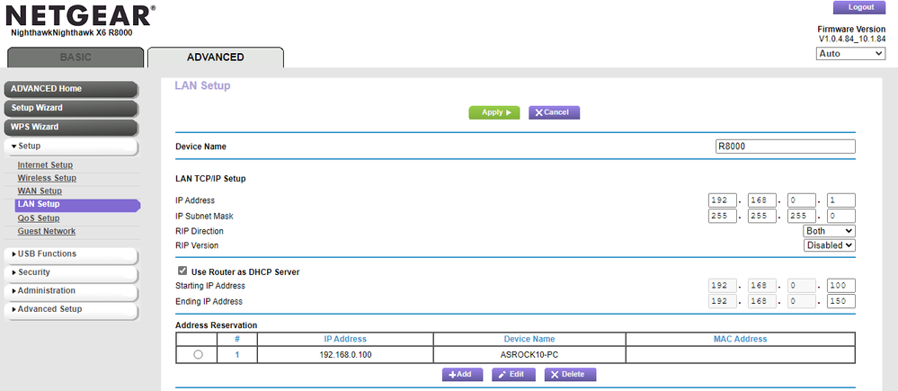

Just checked my R8000 with MS Edge and was able to set a reservation for this PC:
No errors seen.
