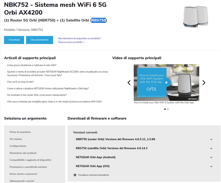

My system: NBK752 (NBR750 router and three RBS750 satellites, wired to the router).
Everything was fine until yesterday.
Today I decided to update the Router’s and Satellites’ firmware. There are many report of possible security issues related to the old firmware.
I followed step by step the procedure: Orbi login, update manually a satellite at the time and finally the router.
Everything went fine. I noticed that the Router’s firmware number was different from the one for the satellites but they were both reported on the Netgear support page.
