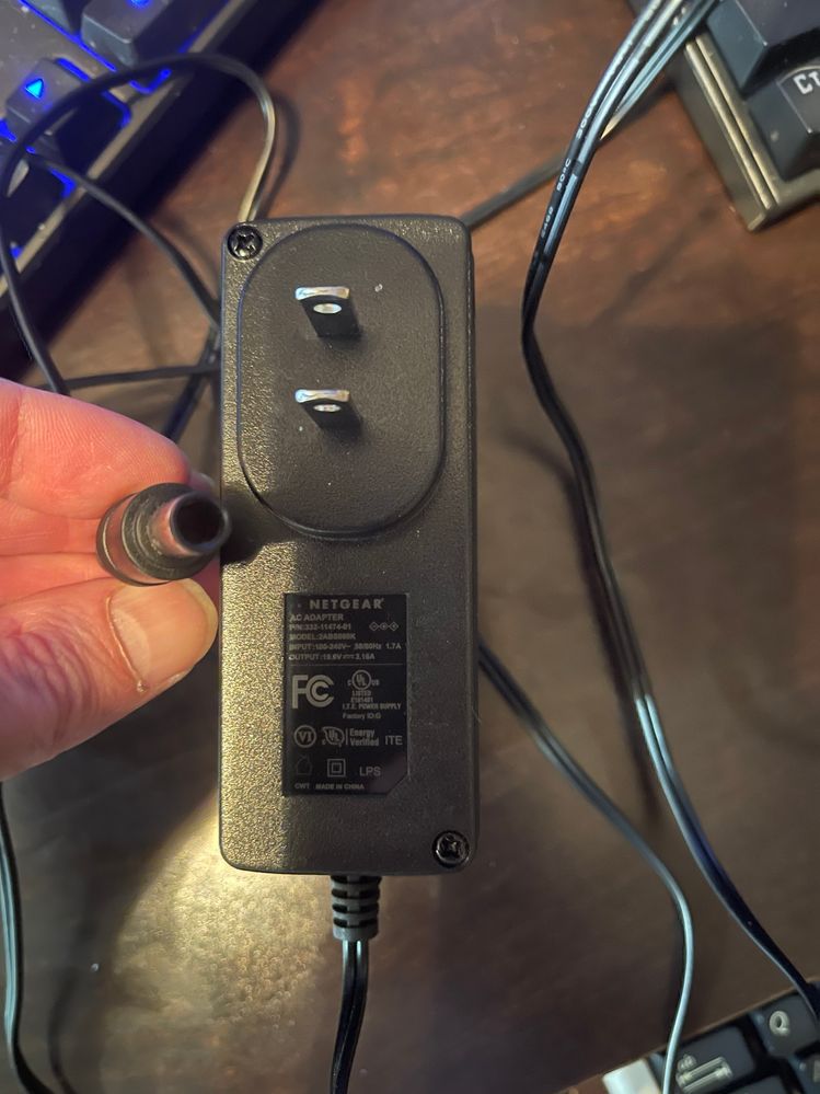

- rhodan777Dec 10, 2023Tutor
this seem right, 7~ mm dc jack.
Could you please name the model in the photo?
I may purchase the power supply for that model instead.
thanks in advance.

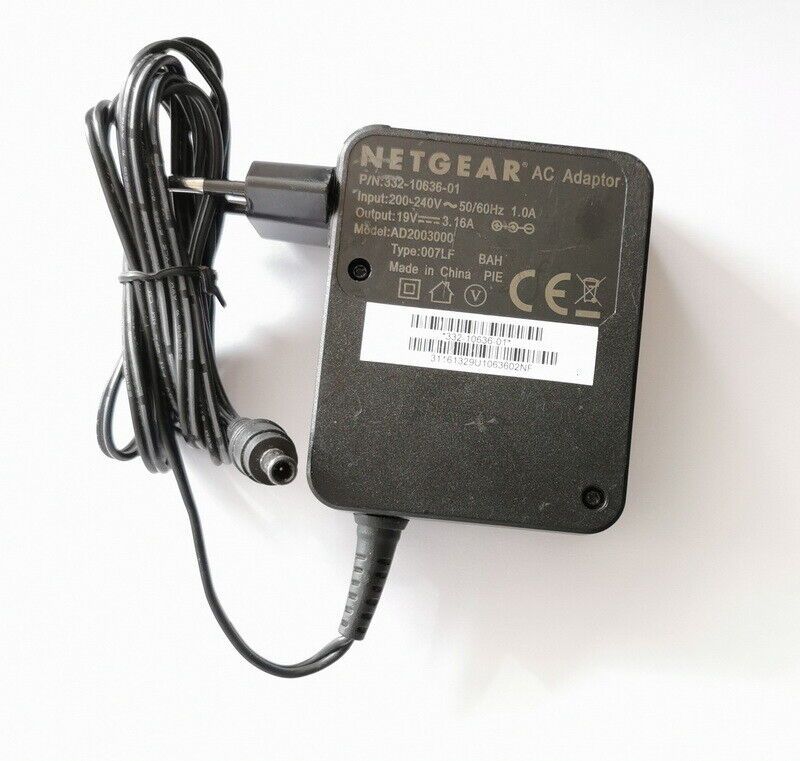

- schumakuDec 11, 2023Guru - Experienced User
This looks like a RAXE500. Either way, even if you are able to find the right power supply, it won't make your FCC RS700 router a worldwide or European model - because newer US FCC regulations do not allow products sold and offered allowing user-control over the wireless bands supported. Better return it to the US seller - because it's not coming with controls to configure eg. the European band plan -and- because it's not coming with a CE mark. If e.g. Switzerland customs will find such a device in a shipping to s Swiss address, it will be destroyed and not forwarded to the customer - and you will be fined, too.
What hits my eyes when looking at an ebay offering of a Netgear branded EU 19V 3.16A AC Adapter Charger For Netgear RAX120 RAX80 RBS40V XR700 Router (Dr. Google is your friend) is the small center pin - because this is an industry standard model for powering laptops - and the center pin is also carrying some constant power, originally intended to power a modem or wake-on-LAN. And oddly, the newer Netgear 19V 3.16A powered routers don't have the tiny center hole - whatever the idea of the hardware designers was going away from a standard 60W PC power supply. For comparison, the R9000 here is allowing the very same connectors.
Again: If the small center hole is blocked, you might have to remove the center pin (or modify the device accordingly - at the cost of loosing any warranty).
- FURRYe38Dec 11, 2023Guru - Experienced User
This is the PS that comes with the RAXE500 with no center pin. If the power specs are the same for the RS700, and the RS has same thick center pin in the back of the RS unit, then I would presume the RAXE500 PS would work for the RS. The PS pictured in previous post does not have the right size end plug, too small and has the center pin that can't be removed.
Correct, excellent example of the newer DC-side plug as supplied by Netgear and probably others.
As I said, the central pin is neither functional nor required for these routers (including earlier Netgear units operating on 19V). A typical power supply sold in the US FCC market (or given to us with Beta units) - well visible based on US-Style AC plug, the UL- and FCC-regulatory marks, and the absence of a CE mark.
