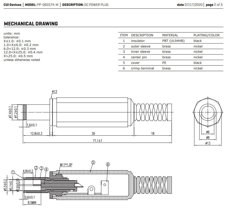

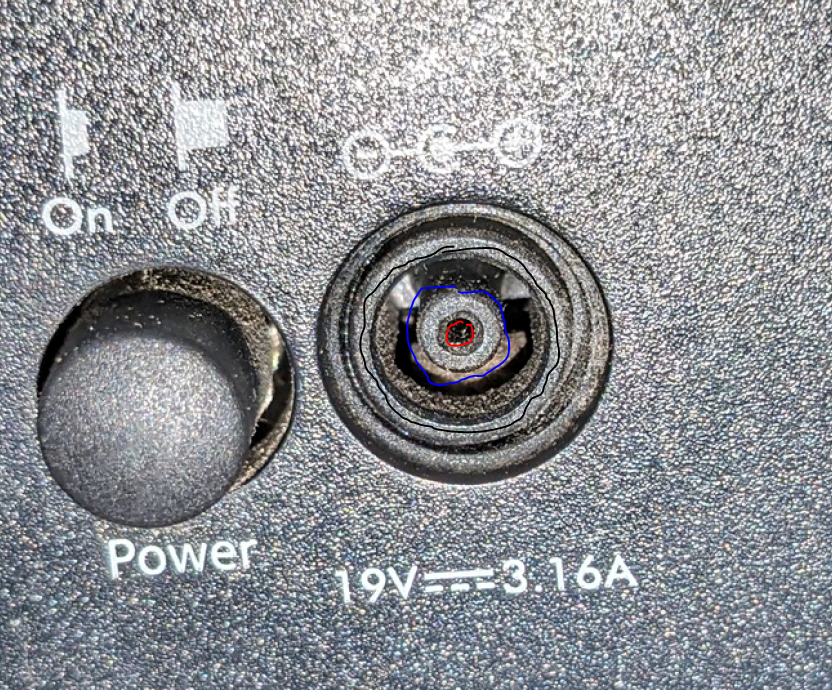

Appears you talk about the router side - there is no center pin (which would be only about 2.5 mm!) in the original design intention of these power supplies. Not sure you understand there are three contacts on the original design, look here
This is what I'm talking of - please don't make it a mess, as we have many users here reading ...:
RED: 0.6 mm center pin ... no longer in use or accessible on the newer Netgear models (==blocked, this is the modem or WoL power on PCs - this pin needs to be cut off for using a standard PC 60 or 90W power supply)
BLUE. 5.5 mm - Inner contact ring ... my guess is +
BLACK: 7.4 mm - Outer contact ring ... my guess is ground -
No guess work .... I leave it to the better informed people, which is the + and which is the - side.
Source: https://www.cuidevices.com/product/resource/pp-065574-m.pdf
