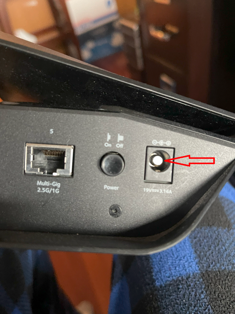

I need 220v power supply for RS700
I need 220v power supply for RS700. I purchased RS700 US version and since it has big dc power jack, it is hard to find something like this. any suggestion?

No, I'm discussing those routers that have the LARGE center pin seen on the router side in back as seen here:
Recent and newer model routers that are 6 and 6E supporting seem to now have these large power plugs with the LARGER center pin. My RAXE500, CAX80, RBR960 and RBR970 all have the LARGE size plug. I don't know about the RS700 has I don't have one of those so I can't confirm.
For the small size and center needle pin plugs in back, my R9000, XR700 and RAX120 have that small size plug and yes, use that same PS model you pictured. This plug is smaller size and will NOT fit the larger sized plugs ever, seen in back of those routers with the larger size plug and LARGE center pin as seen in my picture above. The diameter IS different.
Been a long time electronic standard that most any center pin is the (+) positive side of the power and the outer portion of the plug is the (-) negative side of the power. Been in electronics for 30+ years so you get to know it. No guess work here.

What appears to be a large center pin is in fact the part where the connector inner sleeve does connect - the blue ring in my photo. Most likely the (+) connector as per the printed label, too. The red ring is the (-) connecting the connector outer sleeve. Have posted the exact mechanical drawing above for your reference.
Still can't understand why Netgear has dropped the standards compliant three-contact-connector in favor of something non-standard or at best some variation. This does "protect" the user from using industry standard 60 or 90 W 19V power supplies, and causing more confusion than what's required. For a 90W power supply, this makes just a max of4.75A, for 3.15A for a 60W unit. Weak point will be the very thin outer sleeve contact if any, extremely asymmetric connector design - making fat 5.1mm thick fat contactor is electrically an overkill. The outer plastic ring is massive enough in my opinion.

The outer diameter is 7.4 mm and the inner diameter is 5.1mm.
