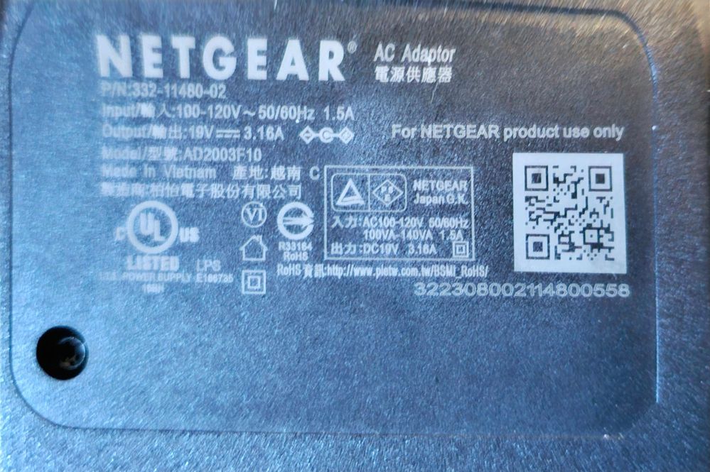

Was asked to post the picture of the power plug end and the socket on router so here we are... no pin in the middle of the plug.
Dec 14, 2023Guru - Experienced User
Thanks jessejames87 for posting that. Confirms it's the larger center pin as I suspected. I see the pin is (+) as well. Glad that's still standard.
So maybe possible for the RAXE500 PS that could be compatible. Can you post a picture of the PS label from the RS700?
- jessejames87Dec 14, 2023Apprentice
not the best photo but legible.
- schumakuDec 14, 2023Guru - Experienced User
All newer models like the RS700, WAXE500, WAXE450, ... share the same 19V/60W power supply DC connectors. The same power supplies can be used on -all- 19V DC units like the R9000 with the (fully standard compliant) APC models, the small inner 0.6mm pin is is not required. This variant is much easier to be found in the free market then want I think is the proprietary modded one.
