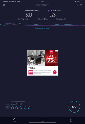

My new RS700s packet loss
Hello, i replaced my existing AC router with new RS700s router. the speed is incredible higher through Ookla speed test. but i saw the that there is always packet loss. ( never happend with my old ...

yes, i updates the router to the latest firmware version.
i tried also to check through my iphone, i got 8% packet loss.
i checked the ethernet cable ( high quality cat 8 and cat 6A cables ) and same issue.
when i reinstalled my old router i am getting 0% loss.
So i believe its something with the router itself.
what would be the solution/how to troubleshoot? Which settings should i check? I purchased my router few weeks ago.
