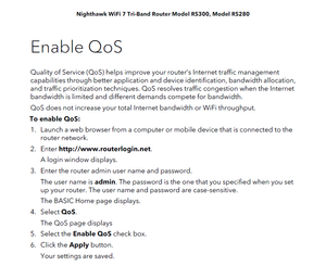

Does the RS300 have a QoS feature? According to the manual for the RS300 I have access to there should be a QoS feature in the router. This is a screenshot of the manual, page 104. I the...

bd73com wrote:According to the manual for the RS300 I have access to there should be a QoS feature in the router.
Odd, that is not the manual I am seeing here:
That page in the version I see is in the uPNP section, and there is no reference to QOS

I now see that the manual I found was from May 2024, so that explains the difference. Maybe at some point QoS was a feature, and they removed it from the FW.
My question was whether the RS300 have a QoS feature or not, and now I know for a fact that it doesn't.
