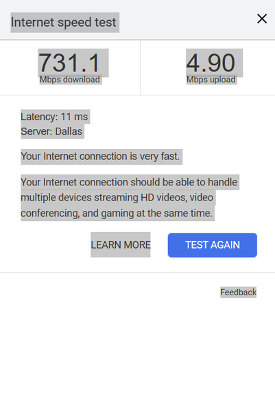

Nighthawk RS600 Slow upload speeds Never over 5 mbps.
I am getting really slow upload speeds on Wi-Fi. I work from home with videos and need the upload speed to keep work going. I bought this router to replace a 10 year old asus and currently the asus i...

- Chad2tjcDec 14, 2024AspirantIt has been reset 2 times. I am using iPhone 13 Pro Max, Dell XPS last years model i7 And an hp desktop that is new in the last year for editing. Also very fast computer. Wired I get 1500 or so up and down. It is only the WiFi up that is super slow.
I don’t recall the modem I’m not at the house but wouldn’t it be odd that only WiFi would be effected by a modem.
Just wondering if this slow speed is common or again a Qos issue!?!?
