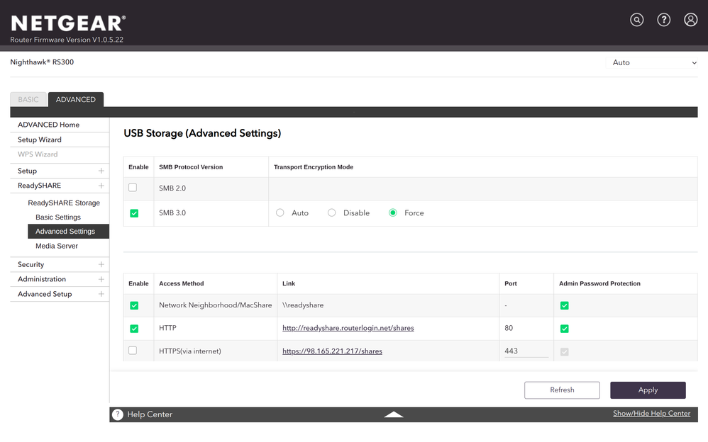

The Chromebook is currently plugged directly into the router via 2.5Gb Ethernet cable. The network connection is reliable and stable. We've also verified the same for all WiFi bands available. Layer 3-6 connectivity is not the issue.

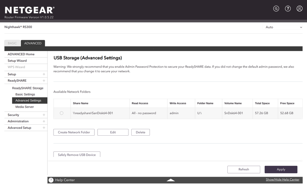

We've tried assorted USB 3.x thumb drives, including the current SanDisk 64GB. They were reformatted according to vFAT, in order to be compatible and recognized by the Netgear Nighthawk's ReadyShare system.
ReadyShare (SMB server) can be accessed through the Google ChromeOS native Files app. It features integrations with Google Drive, MS OneDrive, and a rudimentary feature for connecting to Windows shares by name. It is unclear if browsing the network is supported.
It seems that ReadyShare was working a few days ago, but I'm unsure.

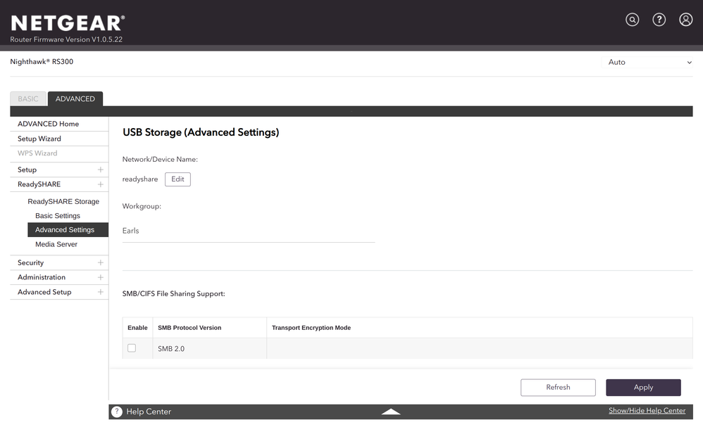

Now the Nighthawk itself is named "Babylon4", and its SSIDs uniformly named "Babylon4_nomap". However, the ReadyShare configuration insists on the default name, and behaves strangely when we try to change it. That's fine. We'll test with whatever name is given.
ChromeOS definitely supports SMB 3.0+ and should never be attempting a 2.0 negotation. Disabled for security reasons. The "Network Neighborhood" service is enabled on \\readyshare link. Password protected.
The share is enabled, and DLNA Media Server is enabled.

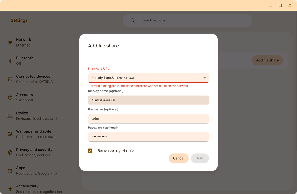

But the widget in Files just isn't seeing any network shares; a dropdown list of none; typing in manually yields no joy.

    Have you tried \\router-ip (using the local address of the router)?
    Does the DLNA server work properly with the chromebook?
    You might also want to try formatting the drive as NTFS
    • https://kb.netgear.com/24059/What-are-the-USB-drive-requirements-for-ReadySHARE-on-my-NETGEAR-router

      At any rate, we figured out the issues and worked out the kinks. The SMB file sharing seems to be working good enough to share among ChromeOS. Android 16 is another ball of wax. We're unwilling to use 3rd-party sus apps to handle SMB. Google Android seems to completely lack any drivers or support natively for that sort of access.
