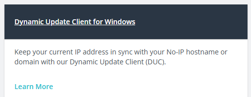

Just as a technical note: the DDNS process on the RS300 does not actually have to function for VPN to work. (Bear with me, please.) Once the VPN configuration file has been created, the point is to have a valid URL to resolve to the current public IP address of the RS300. With UDP ports 12973 and 12974 being forwarded through the Xfinity to the RS300, any process that updates the DDNS service when the public IP address of the Xfinity router changes. As Xfiinity says, it could be any device on the home network that can update DDNS. No-IP.com offers a Dynamic Update Client (DUC) which can be installed on Windows, Mac, and Linux https://my.noip.com/dynamic-dns/duc:
