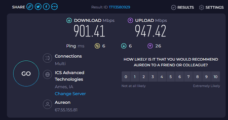

Latest Update: I have contact netgear support and spent about 2 hours on the phone with them. We all the usual stuff that Tier1 offers: reset router, disabled security/Armor etc, disabled Smart Connect Wifi, changed out cables, tested with/without the router. Without the router we get 900/900 (directly connected to 1 PC).
