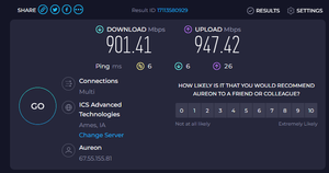

RS500 unusably bad upload speeds
Am I missing a setting somewhere?!? What the heck could cause this? Summary of the situation: Upgrading from RAX80 (AX6000) to RS500 (BE12000) Gigabit Fiber at home 1gig up down symmetrical. ...
