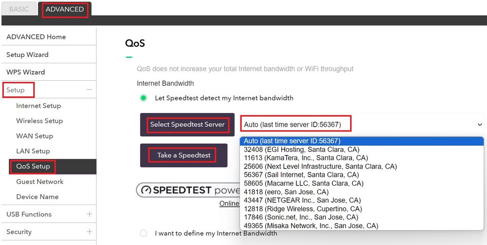

FYI. You can select different speed test server from the RS700's Web GUI:
1. Go to the QoS Setup page in the Web GUI: Advanced tab / Setup / QoS Setup. Note: do NOT go to the QoS Setup page from the Basic tab.
2. Click on the "Select Speedtest Server"
3. Then you can click on the "Auto (last time server ID: xxxxx)", then a drop-down menu shows up, you can choose different speed test server from the list
4. Clik on the "Take a Speedtest" button to run speed test against the selected server.
Please see the screenshot below. Note: the servers in your list could be different from mine.
