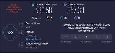

Okay - definitely something here.
ONT -> GS108 -> RS700 WAN Port
The wired and wireless download speeds are certainly reduced, by about ~200MBPS or so on both wired & wireless interfaces, but let's put that aside for now...
Upload speeds increased dramatically on wired, and notably higher on wireless too...
Wired (MBP M3 Max via USB C Gigabit adapter) pushing ~790Mbps++ Upload
Wireless (Same client, 6E Interface) not great at ~350-420Mbps upload ~508Mbps peak, but better than the 60 or 70Mbps I was getting
Lenovo ThinkPad client Win11, similar results. (Download speeds took a hit compared to ONT direct, but upload is flirting with the 8/900s Mbps ^)Just a reminder, for context, the Linksys Velop 6 (MX5300) this replaced would have sustained near full-1Gbps speeds up and down. I simply bring this up to share what my ONT would sustain in real-world. I'm not trying to rub it in "some older competitors router blows it away". Just a statement of fact in the positive spirit of troubleshooting.
While this is better, it still leaves me wondering why download isn't stronger, especially on the wired side. When running the ONT directly to RS700, download speeds were around the 7-850Mbps++ mark.
Photos attached. (Pardon the mess, had to move cables around to make this test work.) I also have a managed MS510TXPP switch, I'd prefer not to disrupt it but if helpful for testing anything, throwing it out there.
