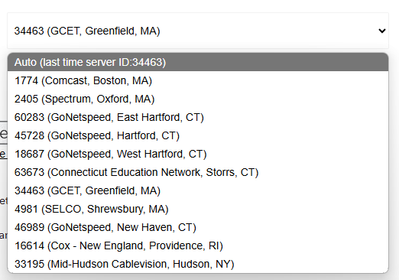

Can you try the RS700's speed test vs. some other servers? You can choose different servers from the Web GUI:
From the Advanced tab -> Setup group -> QoS Setup menu: (1) click on the "Select Speedtest Server" button first (2) choose a different server from the slection box on the right. Please see the screenshot below. Please try a few other servers.Besides, when you connected the laptop to the CM3000, did you use the same Ethernet cable that was used to connect the RS700 to the CM3000? Let's make sure the same cable is used.

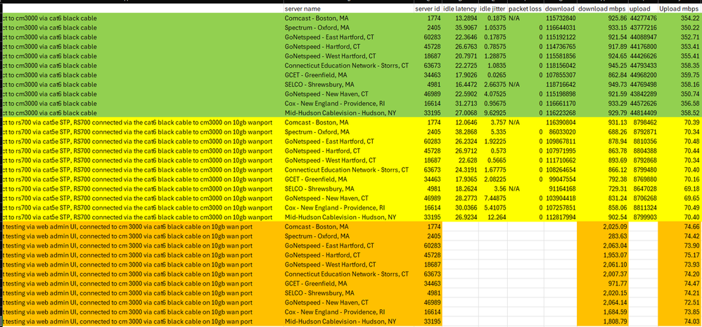

So i have two cables involved isolated for the testing purposes, i have the cat6 flat black cable that shipped with the rs700 and i have the yellow cat5e STP that shipped with the CM3000. i have tested both cables one at a time direct to the cm300 and got the expected test results on the laptops of the roughly 950* down / 300 up as expected (*i only have a 1gb dongle but this is a test of upstream, down stream as that is happy).
I conducted three sets of tests this took a couple of hours
i pulled all the serverID's from the QOS test page interface and wrote a quick batch file to run speedtest.exe at the CLI so i could export results
I ran the batch file on the laptop under two connections
Direct to CM300
Direct to RS700 via port 4
the router does not have a CLI so i ran each server location manually and transposed to excel
from these results we can see that the direct connect regardless of the serverid gets the expected upstream performance
we can then see that when the rs700 is involved the upstream performance drops regardless of if its on router testing or on laptop testing the results are nearly the same (a suspicious consistent 4mbps tax on the laptop connected to rs700 vs rs700 on appliance test 74 vs 70)
*the router based test doesnt give nearly the details that the CLI test on the laptop gives hence the white spots
*a couple of the test servers seemed to have cripped when hit with a 2gbps load but this is kind of expected and does not changes the findings of the upstream
