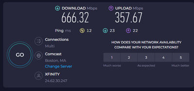

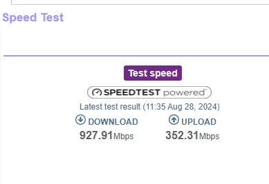

Upload speeds RS700 are slow when compared to etherneted laptop direct to cm3000
Slow upload speeds from rs700+cm3000 2gbit down / 300mb up service plan i am contracted for Comcast tech just left and did a meter-based speed test on the coax line. the coax line tested at 23...

even for being older gear the rbr50 had zero issues hitting 350~mbps (it does not support past 1gb hence the 927) up both on laptop and via web admin console
further indicating that the rs700 has something going on with it, i would hate to think that its actually bad hardware

BH_C so now the next theory to test is the thought that speed tests being ran where not updating the QOS limits well it was enabled and that testing with no ofdma locks got hard coded in to the qos config at 75, but disabled and re enable should re read in the test results? if this is the case that feels like a defect where qos limits are not dynamically updating on test runs thus needing to disable/re-enable. i would think that should be dynamic

Power needs to come down a bit more I believe, should be between +7dbm and -7dbm.
Please post the event logs from the mode as well.
- Clonea1Aug 29, 2024Aspirant
right correct, yeh i tried to post before and after and it told me 'access denied' and double posted the before
here is after deleting the amp fromt he line and adding a splitter that has a -7dbmv tax

2 Not Locked 0 0 0 Hz 0 dBmV - FURRYe38Aug 29, 2024Guru - Experienced User
There we go.
Please post the event logs from the modem as well.

Enjoy. 📡 - Clonea1Aug 31, 2024Aspirant
This is curious and of no impact but did i find a bug?
went to go test QOS tonight and found that the display reverted back to the 73mb even though this test has been re ran a few times
clicked into QOS saw this
re ran the test got this
clicked apply to 'save the test', QOS page reloads after the apply to this (no i did not re use the print screen i took a fresh one
re run the test and its where it should be, so is it saving off the old information and not updating it ? new bug ?
so i re re ran the test clicked apply and when the page refreshed it still is reading the 73 BH_C i think we have a bug, how do we report that ?
- BH_CAug 31, 2024NETGEAR Expert
The "Apply" buttonn does not save the speed test result. The old data could be the cache in the browser. If you open a new browser window in the Incognito mode to access the router's Web GUI, will you see the old test results?
yes in a new private browser the same is displayed, as well as the same from a different machine, and the odds of a second machine also having the same cached values is pretty low i would think
from my laptop in private
from a RDP with my server also in private
- Clonea1Aug 31, 2024AspirantAnd more of the same from my work laptop that has been in a bad for a week and half that I have been on vacation and pre dates me owning the rs700
