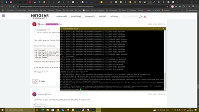

ToddeSwe wrote:
I'M IN it worked but after the two black shell windows and loged in nothing more happens...
Yes. I didn't give you the rest of the steps.
Now enter these commands:
cd /etc/apt
cp sources.list sources.list.orig
cp /data/Backup/apt.conf .
cp /data/Backup/sources.list .
apt-get update
Note that the bottom two cp commands end in a period - don't leave that out.
If you see any errors, stop at that point and post a screenshot.

- ToddeSweMar 03, 2025Guide
If i had read carefully i had noticed that you told me to put in root as a username. 🙂 I have now done all steps but there was some errors at the end, se picture. Maybe its normal?

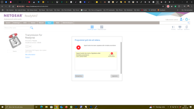

I've just installed Transmission and when i start it in NAS settings it gives me this screen:
What to do here?
If i want to update wich one is it?

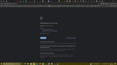

Nope
Is there a possibility that i wrote a letter or something wrong ... but don't it says so when pressing enter....
Here's the input i did
- StephenBMar 03, 2025Guru - Experienced User
ToddeSwe wrote:
Nope
The screenshots look correct, and of course transmission did install.
I don't have apps installed on my own NAS, so I can't give advice on specific apps. But none of the update packages in your earlier screenshot were appropriate for readynas.
Almost all the ReadyNAS app versions were created by third parties (not Netgear), and the folks who created them generally aren't maintaining them. One of the few exceptions is plex.
Honestly, I think you are better off installing stuff on a PC.
