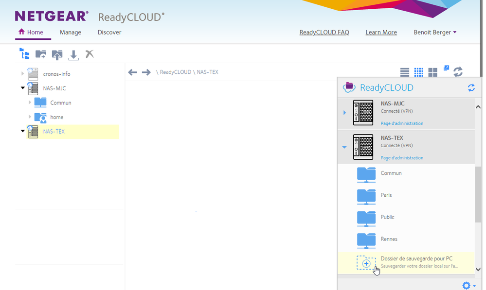

I have take a snapshot :
In the app you can see the NAS-TEX (RN212 with readycloud malfunction) with the readycloud main account : Folders are presents.
In Chrome you can see the NAS-TEX with no folders. There will be at least "Commun" and "Rennes", the rights are checked in readycloud and on the NAS.
As you can see, the NAS-MJC show some folders. It is the same model and the same method to share folders... The same Internet provider, the same model of router and the same configuration...
What do you think about it? (I'm lost...)
