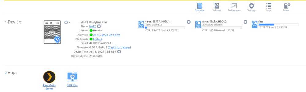

Ready NAS 214 running Plex server. Windows 10. Recently my NAS firmware update failed. The result a factory reset proved to be the only solution. My quesion is there a tutorial blog and or v...
CABird_UK
Jul 18, 2021Tutor
Hello StephenB
Big problem now.
My folders share disappeared.

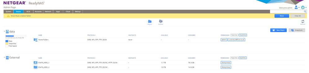

Example of what should be there.
Now folders are not listed including ReadyCloud but data is still there.
Please tell me I don't have to run factory reset again.
Thank you.

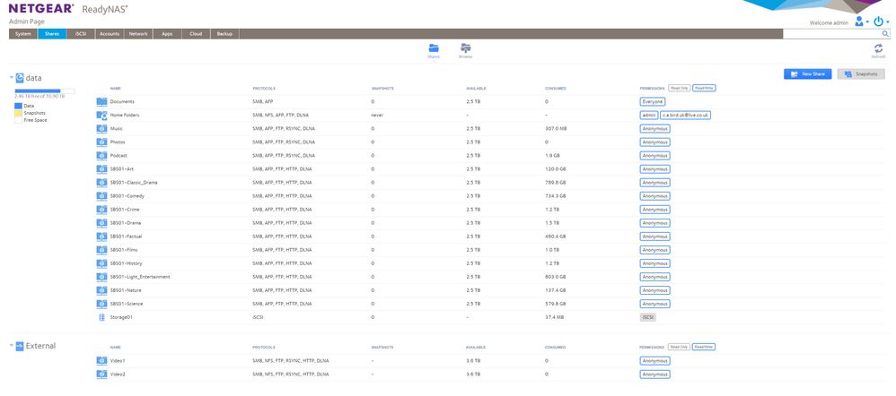

Example list of the folders missing
https://1drv.ms/u/s!Ak789NvNyMQ3orwzg5-oTdm4MMnLHA
Example of what folders are listed
https://1drv.ms/u/s!Ak789NvNyMQ3orwyOe_TST5A6b_bkw
The data was there yesterday despite folders not being listed. I suspect the data is present.

It's best not to post the log zip publicly, as there is some privacy loss when you do that. I've redacted the link.
Disk 4 did have one command timeout - not clear why, but that is what triggered the resync. Since it is new, you could probably exchange it with the seller (instead of simply buying another).
The data does appear to be there, but the share configuration files are definitely damaged. Systemd-journal.log is flooded with these errors:
Jul 20 04:04:58 NAS2 readydropd[6219]: DEBUG:readydropd.c:650 Reload Share configs Jul 20 04:05:00 NAS2 readydropd[6219]: DEBUG:readydropd.c:650 Reload Share configs Jul 20 04:05:02 NAS2 readydropd[6219]: DEBUG:readydropd.c:650 Reload Share configs Jul 20 04:05:04 NAS2 readydropd[6219]: DEBUG:readydropd.c:650 Reload Share configs Jul 20 04:05:06 NAS2 readydropd[6219]: DEBUG:readydropd.c:650 Reload Share configs Jul 20 04:05:08 NAS2 readydropd[6219]: DEBUG:readydropd.c:650 Reload Share configs Jul 20 04:05:10 NAS2 readydropd[6219]: DEBUG:readydropd.c:650 Reload Share configs
...Email alerts are not properly set up - the NAS is trying to send you emails, but those are failing.
Also, I can see what you entered in ssh - those commands would not have damaged the share configuration files (or done other damage). The OS partition isn't full, so that didn't cause the damaged configuration either.
