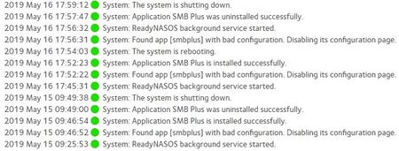

May 18, 2019SMB plus not running on RN104 under OS 6.10.0 Hotfix2
 While not having any issues with my RN426 (OS6.9.5 HF1 Long-term Support) and RN204 (OS6.10.0 HF2), good ol' RN104 (OS6.10.0 HF2) is refusing to run SMB plus, though it claims that the app was succes...

Just for the records: Upgrading to 6.10.1 a few minutes ago is not fixing this. Installation and De-installation is successful, but the configuration page cannot be invoked as the system has disabled it (see screenshot in first message of this thread).

Yea, it looks like there are two different issues in this thread.
The issue that Retired_Member is having is related something on the apache configuration. You can run the `apachectl -t` to check the current apache configuration and see where the error is coming from in the configuration files.
